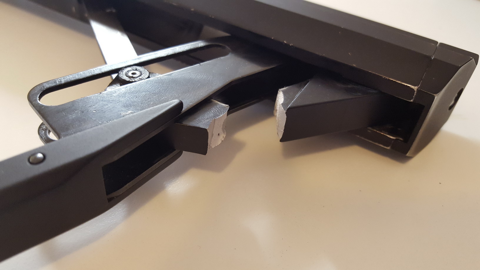

Are you shure that the pistol done 2000 shots only ?
The Pistol is old, I think it`s much more.
ah. i;m sure in it's life it shot a lot more. it;s 25 years old.
i was saying that I shot ~2000 shots since i got it from egun.de

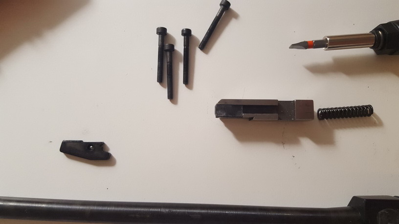

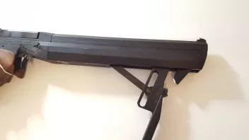

Unscrew the front screw, then pull off the parts of the body starting on the muzzle.
maybe there are spareparts from Feinwerkbei!
in other way a good mechanican could construct this part again.or buy here:
https://www.waffencenter-gotha.de/shop/Ersatztei…-100::3413.html
mfsg daniel

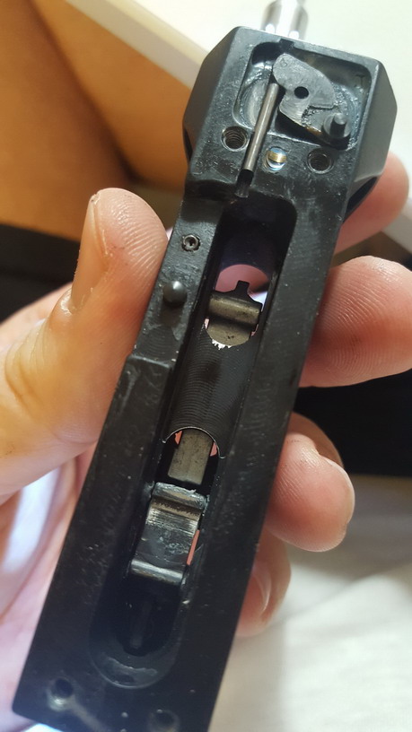

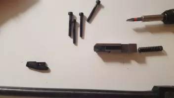

i have the exploded drawing... but it;s minimal information. there are some pins that look very hard to pop out.
i was hoping someone had this problem before and made some pictures/video of how to disassemble that part.
here comes my suggestions:
(all numbers of exploded drawing)
phillips screw drivers, pin punches, hex wrenches, thats all you need!
its not difficult - it is just a air pump!
greetings
i got the part and successfully replaced it. the pistol now works ok.

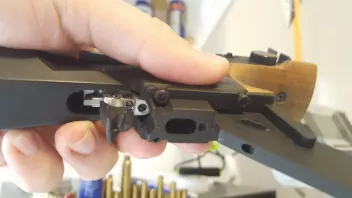

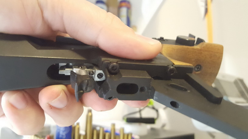

however, another issue came up: trigger weight.
after i got the pistol in february, i tested the trigger weight with a homemade 500g weight and it was ok.
after some time i tested it again and it was a little off. i screwed in screw 3 a little bit and it was ok.
now i tested it and it was off again. i had to screw in quite a bit to get it not to fire at 500g. second stage now it a bit heavy.
is this normal? or i have (another) problem with the pistol?

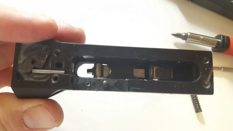

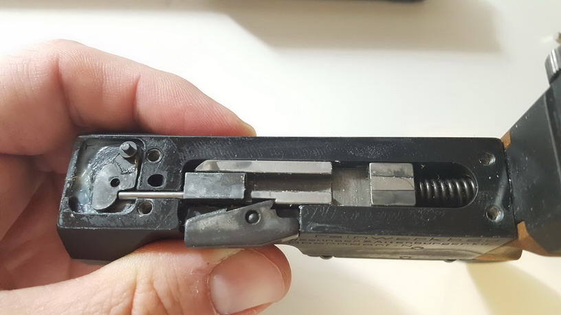

hi

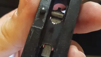

the trigger problem got worse in time. now, especially during dryfire, the pistol fires at a VERY light pull without moving the trigger at all
see video: https://youtu.be/aZ9Mg5jONRg
i recently took it apart and cleaned it.
the problem was not resolved. i have no idea what is the problem or what part of the trigger mechanism is broken. any help?

yes.
i cleaned the whole trigger mechanism, applied FWB paste all over (this was mostly missing) and than i unscrewed the power screw (9) as much as i could (it was screwed all the way in) - tested with the chrono to maintain ~140m/s V0
i think the problem was the missing lubrication.
the gun has been working fine now with no problems for ~ 6 months
