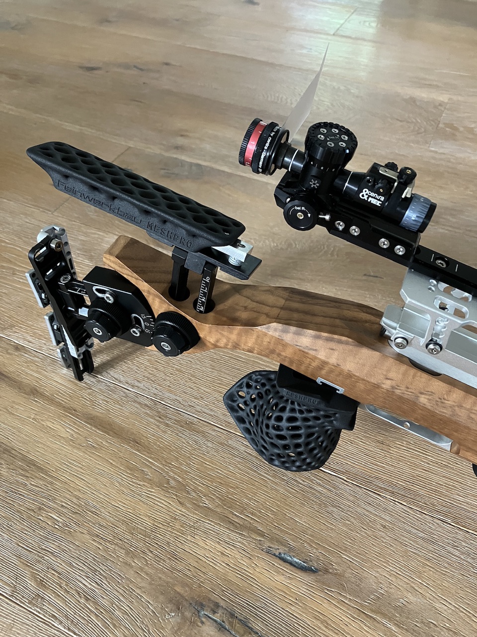

    Feinwerkbau 900w Mesh hybrid (Walnuss)
    Centra Spy BR + Centra Sight 3.0 Filter Optik + DoubleFit-Schaftbacke + tech HRO touch point + DuplexVario + QY Pellets
